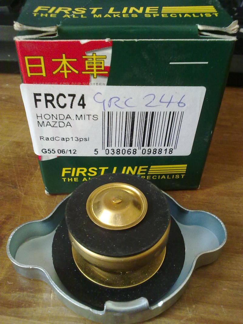

With a growing hijet radiator cap grave yard growing in the top draw of my tool box, it's time to get some new caps. Here is some of my collection of what I would called f***ed caps.
  • the seal(s) have a grove depressed into it
  • the rubber is perished
  • the cap lips that hold it on are going crap
  • the central "cooling return valve" in the middle is going weak
  • the middle rubber has swollen causing it to drag on the sides.
The ones on the right are all original daihatsu caps, while the two on the left are motor factor replacements. I have more crappy ones but I seem to have either binned them or lost them.
I have ordered a few radiator caps over the last week, from various parts catalogues, but the ones that seem to be the best build quality and fitment from my enquiries are these:-
As you can see from the above picture, on a new cap the sprung rubber seal in the middle is the same size as the piston when new, but when they are old and worn, the rubber seems to grow then overlapping the edge of the piston. This will not help the function of the cap at all.

I take my, er, cap off to you. The FRC 74 is what I have fitted on both my vans.

I found there is a slight weakness with these caps though.
The upper cap seal doesn't spin round from the cap lid, so when you tighten and loosen the cap it twists the seal out of place. I've found putting a bit of Vaseline or bum lube on the rubber goes a long way - see what you've got to hand hey Razz

i am thinking about buying the one (frc 74) HJ bought in the above post

Yes you can fit an FRC74 to both locations.
This is a controversial subject round here, but if you study the above parts data, you will notice you can fit a 16401-87Z04-000 to both locations, which is a standard cap the same as an FRC74.
