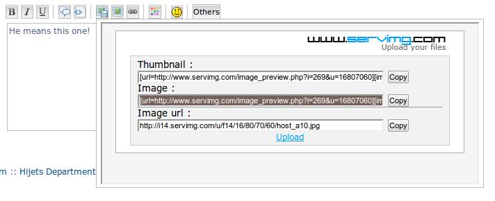

He means this one!
Then once you've selected your file and pressed upload, this window will pop up:-
Simply copy this highlighted text, and paste it into the message text window.
Then close the image tool box by pressing the button again.

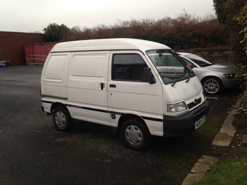

well here goes, here a picture of it, paint work needs sorting but no rot anywhere,

Looks a tidy wee van Smile

Thanks, the chap I got it off used it for gardening in, defo doing the camper thing with it,

Does look like a clean van, get the T-cut and a touch up pen on it if its lost its shine etc. That staining under the lock disappears with t-cut.

Think it might need more than that, it's been brush painted, don't look too bad at a distance, thinners brings it off, god knows why he did it,

People have some strange ideas going on!
Do you think it might be okay under the extra paint?

It's abit poo par but I plan to have it sprayed
