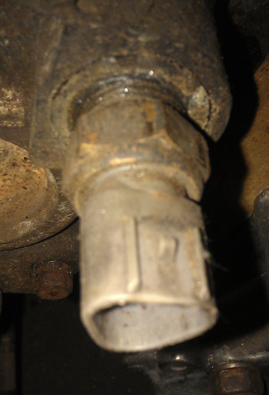

....with fault code flash..flash..flash..flash......flash..flash which is coolant temp sensor oh great turns out to be the sensor bit has fallen out the back of the screw in bit hopefully be able to push it back in, in the morning when it's light.

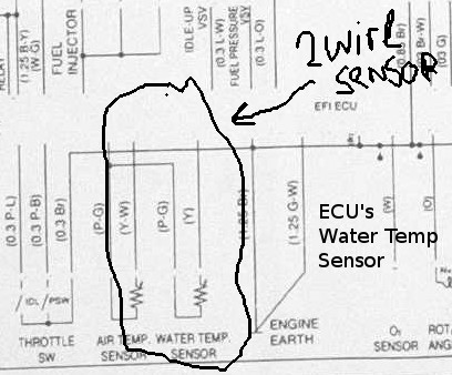

Been to the garage for a clue, and had a look at the wiring diagrams.
Here is the 1.3 hijet combined gauge and ecu sensor, it is a 3 pin jobbie.
Which will not help you I don't think, although you may be able to alter the wiring to use one like this but I wouldn't bother.
Looking at the wiring diagram, yours is like this;-
So you have two sensors, one with two pins that the ECU uses, and one with one pin that your gauge uses.
Which is like the sportrak ones I have in my tool box:-
but as you can see my ecu two wire sensor is broke, it came like that on the sportrak engine I bought.
So that explains probably why your gauge works but your ecu isn't reading the water temp. And if the ecu can't read the water temp it will not be able to up the fueling for a cold start situation, nor will it be able to lean it off for a hot engine. So it will pick somewhere in the middle and run a bit rubbish, and probably not want to start from cold.
Is that any use?
