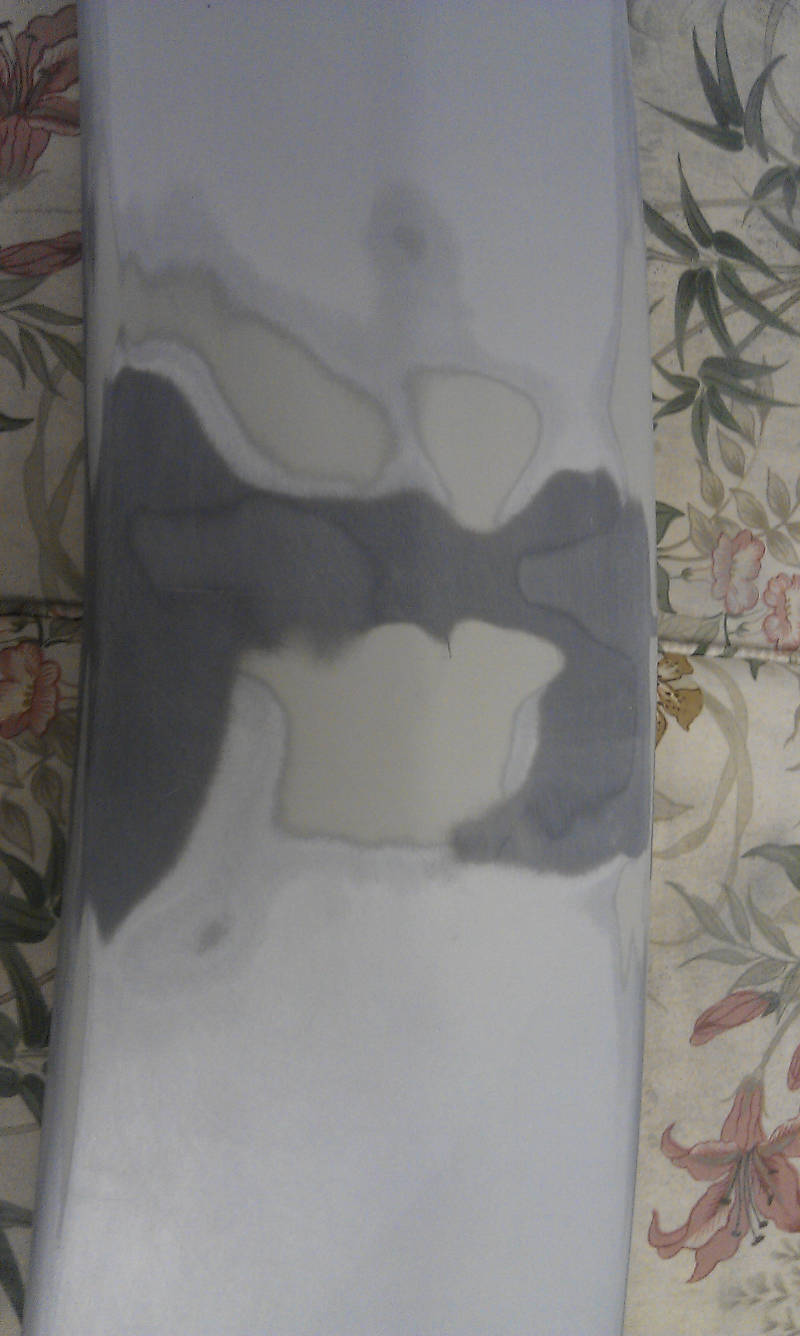

Tonight's little DIY job in pictures.... Hijet spoiler
Need to bond in the reinforcement, fill in the gap, sand it back, refill any pits, sand the whole thing back, then paint it.

If you use some of the bits you cut out you can add extra strength back into the joit use it like filler wire onb the welder and as it is the same stuff it will even better than the commercial plastic welding rods.

I melted the join together best I could then rough sanded it back.
But thats a good idea about using a bit of plastic off cut as a filler rod, just make sure you get any paint off it etc first. I'll keep that idea on the cards.
Anyhoo, I got my join all done and cured, bonded under a sheet of off cut plastic in the big hole, then filled it up with expanding foam cowboy builder style. Left it in the kitchen a few days to cure to properly.
Then this stuff arrived this morning:-
"silver hook big boy plastic flexi filler" - for bumpers and ABS plastic etc
thought its worth a shot as I don't want it to crack. Now my arm is on the verge of falling off but so far looks pretty rewarding...

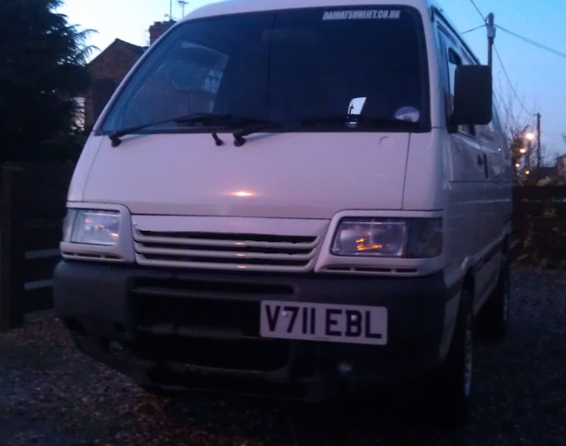

Sneak preview of the de-badged grill...

Is it just me, or are the headlamps not quite sitting right?
Posts : 1486
Re: Spoiling it
Post by HighlyJetted on Mon Feb 18, 2013 11:50 am
What do you mean? It's totally straight, never been crashed

So after about 4 filler cycles I got the surface pretty smooth.
Then I did a few cycles of filler primer and wet sanding to get all the surface imperfections sorted.
And tonight I have smashed it with some coats of base colour:-
Now I need to let it cure for a couple of days before I cut it back to make it nice and smooth.
