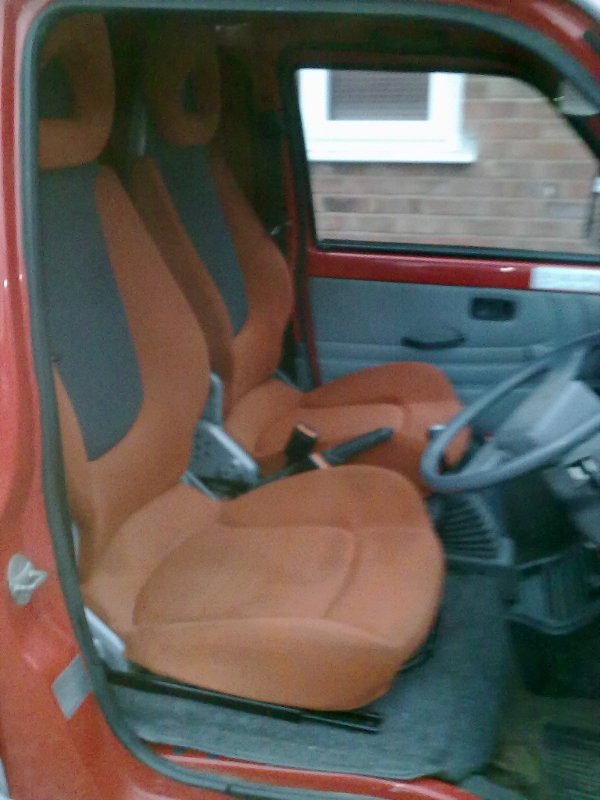

Having a bit of a war with this. Because of the distance between the holes on the Smart seat runners, I can't see how to fit them, or at least, it's very marginal. The length is such that they'd be right in the corner of the engine cover. Am I missing something?

Post by HighlyJetted on Sat Feb 16, 2013 12:31 pm
If you look closely at the smart car seat runners you will notice the drivers side and passenger side are different.
This is free style seat fitting, I'm sure if Logi shows you where he has bolted his down it will be different from my choice.
I used some bolts that I ground the heads down a bit thinner so the runners don't catch against them.
I also think I may have drilled new holes in the runner for the rear bolts to go through on the drivers side, but I can't remember now.
Black dots on the silver foil tape are the original holes.
It's really really easy to do, hardly engineering more cowboy bodgery cheers

Ok, I'm overthinking it. Need to make with the drill. If I get clever with where I chose to redrill the drivers side rails, I can get a bit more legroom (which is nice when you're 6'3!)

where mine is drilled I get LOADS of extra legroom as the smart car runners go really far back.

Beware of siting them too far back, remember the seats need to tip back so if the runners sit too far back on the engine covers they will catch when you tip them back.
I'll need to take pics of mine.

I got the driver's side fitted, with reasonable success. Much more comfortable, but a little higher (I'm 6'3, and now very effectively shaded from the sun), and also a little further forward. I'm wondering about redrilling and moving it back, but my main concern is having rails jutting into the rear cabin that could really muller someone's knees in case of an accident.

Mine overhang a little, maybe 30mm.
The passenger side one I cut an inch or so off the ends of the runners.

I also found using 2 of the original spacers on the front of the drivers seat made it just the right angle for comfort

These are mine, which I bought off gumtree listed as "Smart Car Seats Red" - whatever that means?!
These are Logans which he probably swapped some magic beans or some holly water for them Wink

I can't help but notice your seatbelt guides are on the wrong side! But you've got the flip down seat on the passenger side.
This can only mean that your seat came out of a left hand drive Smart car.
Re: Fitting Smart car seats....
Post by Logi on Tue Feb 26, 2013 8:13 am
Yep, tis why my seatbelt guides are on the inside. Which is handy as I use them as coathooks Smile
