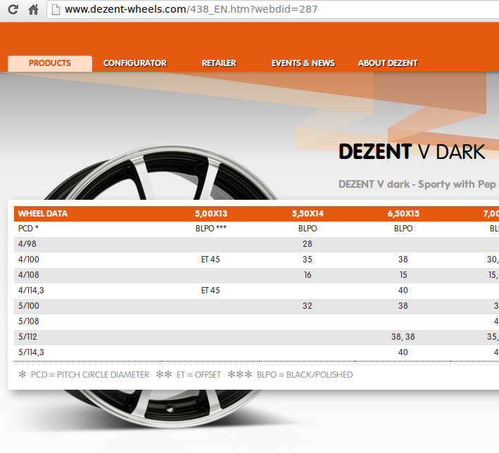

For example, if you look at the manufacturers web site for all the Dezent wheels, you'll find not a single one is manufactured in PCD 4x110 - for example the V Dark:-
Then you can look at the Autec catalogue on the manufactures website herehttp://www.autec-wheels.de/fileadmin/webdata/downloads/kataloge/RP_Tabellen_W2012.pdf and again you will not find a single wheel they manufacture in PCD4x110.
