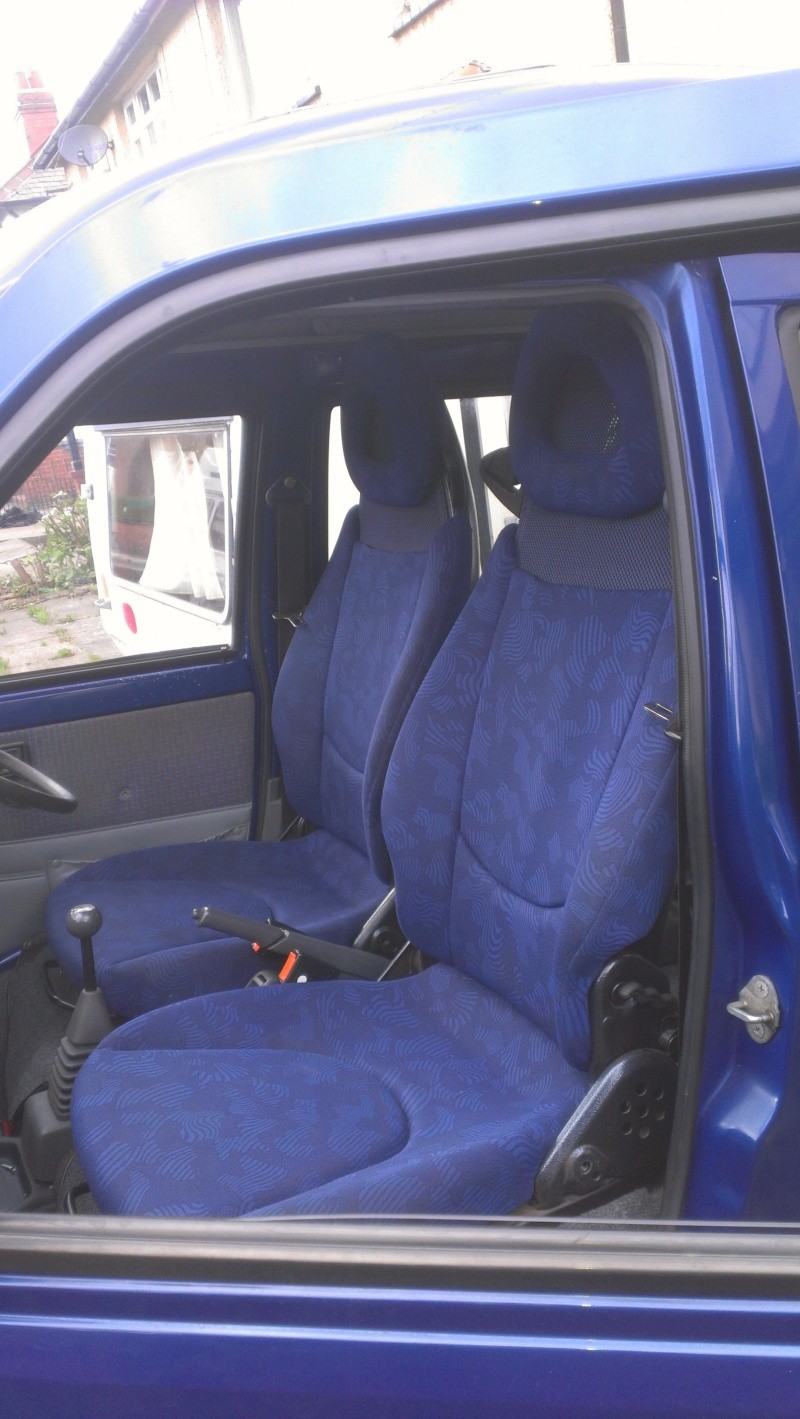

I went for smart car seats in the end, picked up some nice matching blue ones from ebay for £50 that went in with relative ease (pics below).
