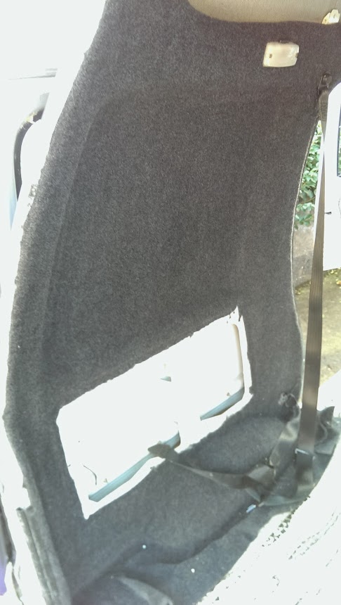

Next up… Interior!
I order a bunch of carpet from http://www.megavanmats.com/liningcarpet.htm as it was highly recommended by the VW T4 lot…
Although expensive it’s great quality and good to work with. It also came with the spray glue.
I started with the door cards, as I thought these would be easy and a good place to start. Over a few days I worked around the different areas of the van.
Rear panel, around the doors, around the front windscreen.
Lastly I ripped out the cloth from the roof and replaced that with carpet.
Once all covered I put the door cards back on but found they kept falling off due to the extra weight and thickness.
I ordered more door card clips but they didn’t work. Instead I decided to screw them on with self-tapping screws and bought washer screw covers http://www.amazon.co.uk/dp/B007IWGU02/ref=cm_sw_r_tw_dp_2d2htb1BCG10W which was a nice finish.
