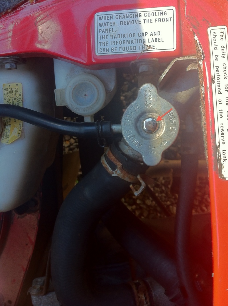

I've just confirmed one of the FRC74 filler caps I'd replaced a couple of months ago has failed. while filling the rad with cap on the underseat filler the expansion tank filled up & overflowed. I put the old heavier duty one back on the the rad & put another on & it's ok for now.
Got any info on how to post a photo?
I see the hose at the back, what about the others there are at least 4 others I can reach , would you change clips on all?

Had a go at posting pic links to the 2 different rad caps, if you can see them I'd be interested if anyone is using the cap on the rad as the filler cap. & if so anyone know where to source them.

The "made in england" cap is a first line cap, they are ok but the seals move on them.

HighlyJetted wrote:The "made in england" cap is a first line cap, they are ok but the seals move on them.
t'other one is better I reckon.

I think the original Diahatsu caps are the best but they are old and tiered now.
There is a guy selling brand new genuine daihatsu ones on ebay, limited supply though.
