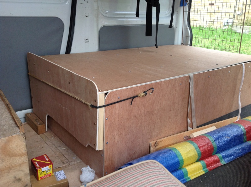

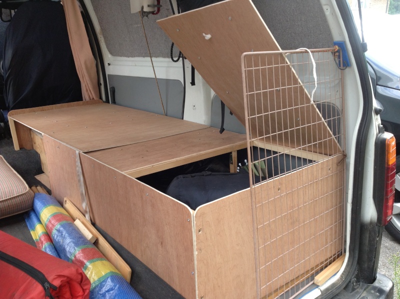

Re: a work in progress
Post by elfin girl on Tue Sep 17, 2013 10:41 pm
in the mean time heres what ive done so far for the seat/bed
still some adjustments to be made and hinges to put on but its useable as is, glad i didnt fix it to the side of the van seeing as im going to have to try to move it to get to the tank bolts
