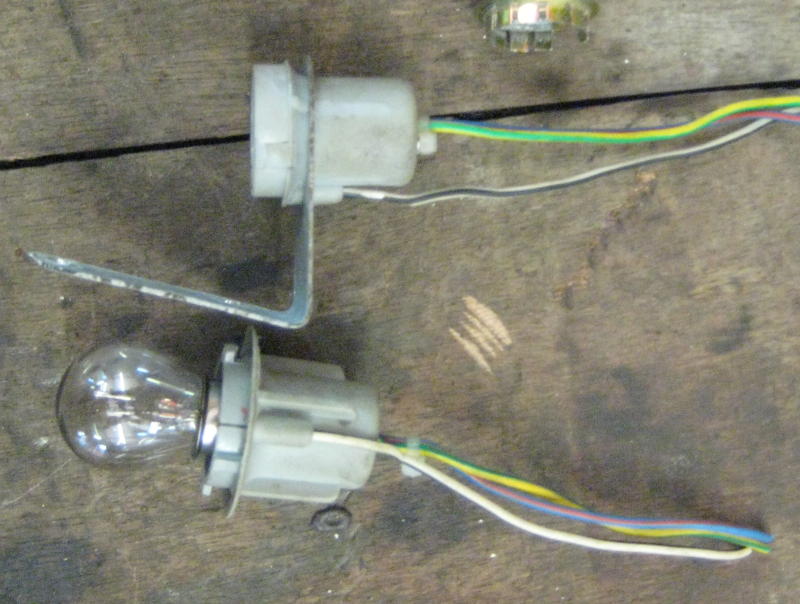

Pictures speak a thousand words or so they say...
So you take your fog light and also get another to match
Drill out the rivets and unfold the lamp holder retainers
Get a pair of stop'n'tail light holders, Hijet ones are perfect but others might work too
Modify the bracket and trim back the lamp holder to fit together
Rivet it back together or bolt it whatever
Now solder/wire the new stop part of the bulb holder to the original fog light connector and plug it in,
And take a the side light feed from the new bulb holder up to the back of the light clusters and key in into the side light feed.
And tada....
Twin tail lights
And fog lights all in one unit

Where did you find 21/21w twin filiment bulbs? Fog and stop are the same rating.
I twin fogged years ago standard right hand one and added the left one when I got a unit given to me.
it is just visable at this angle.
Re: Little rear end modification, twin tails
Post by PFM on Fri Sep 13, 2013 8:03 pm
I don't think they exist - HJ has 4 side lamps at the back now. Though you could parrallel the 21w filament in the fog lamps with the brake lights - then you'd get 4 brakes as well.

rich the mechanic wrote:Where did you find 21/21w twin filiment bulbs? Fog and stop are the same rating.
I still only have a pair of fogs at the bottom
A pair of brake lights at the top
and all 4 are tail lights
Post by rich the mechanic on Fri Sep 13, 2013 9:46 pm
I mis-read it first time it looks good just need a high level brake light in your spoiler now.
