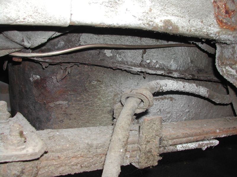

As you can see mud was thick and i feel a bit of gentlemen sausgae for not digging deep before buy
Im a bit of a pussy when it comes to sparks and kaboomy things so tanks coming out, plus ill be able to clean and paint everything and fix the awfull brake pipe repair
Tank is not in best shape but should clean up ok

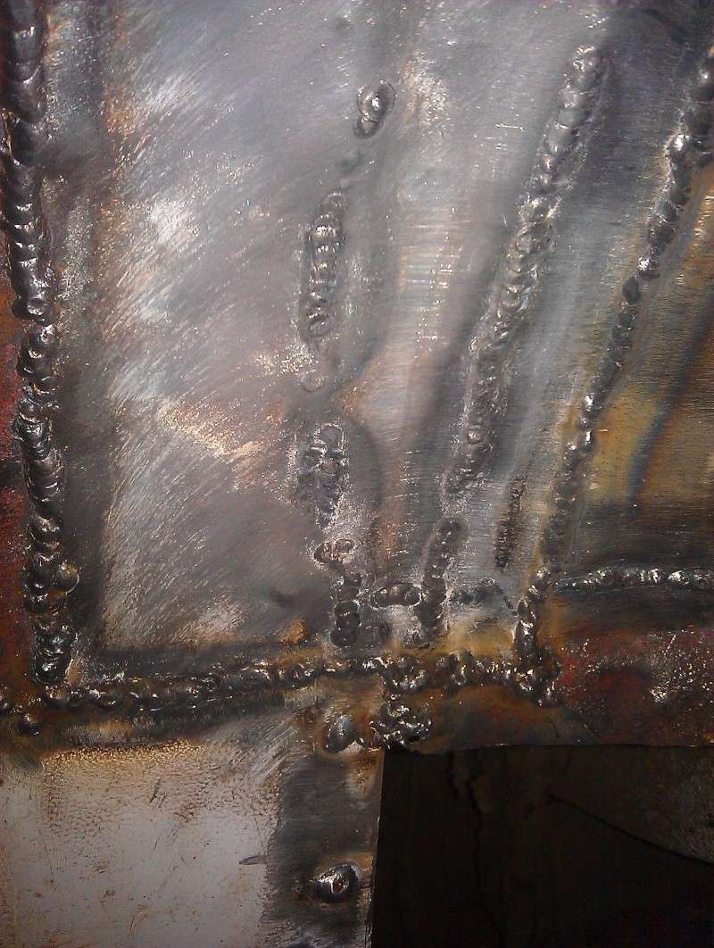

finally managed to get out and do some welding after it been raining all week, didnt get it finished but done most of it so hopfully if weather and my hands are good tomorrow i can finish arch and start welding in rack so i can get my roll cab in:face: Very Happy Very Happy Very Happy Very Happy
ill warn ya now some pics are a bit funny cause of the way sun was and my welding is not the prettiest (but it is solid and is not gonna rust through an time soon)
all rust is cut out to make sure im welding to good strong metal
not good pic but you can see plate is all clamped up, the metal is an old road sign, not the easiest to work with but very strong and free from mate
again not best pic but fully seam welded and solid

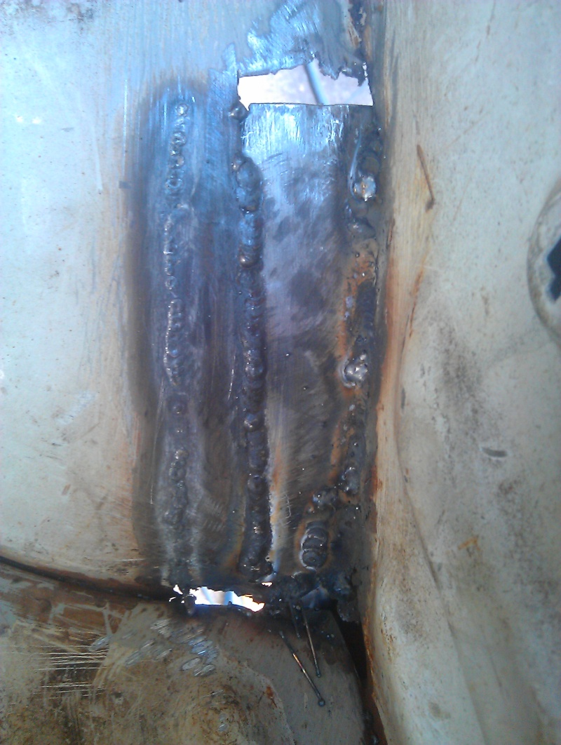

again all rot cut out
welded inside and out and in stages, not the neatest way of doing it but its alot easier to make the plates and you also maintain the shape of the arch

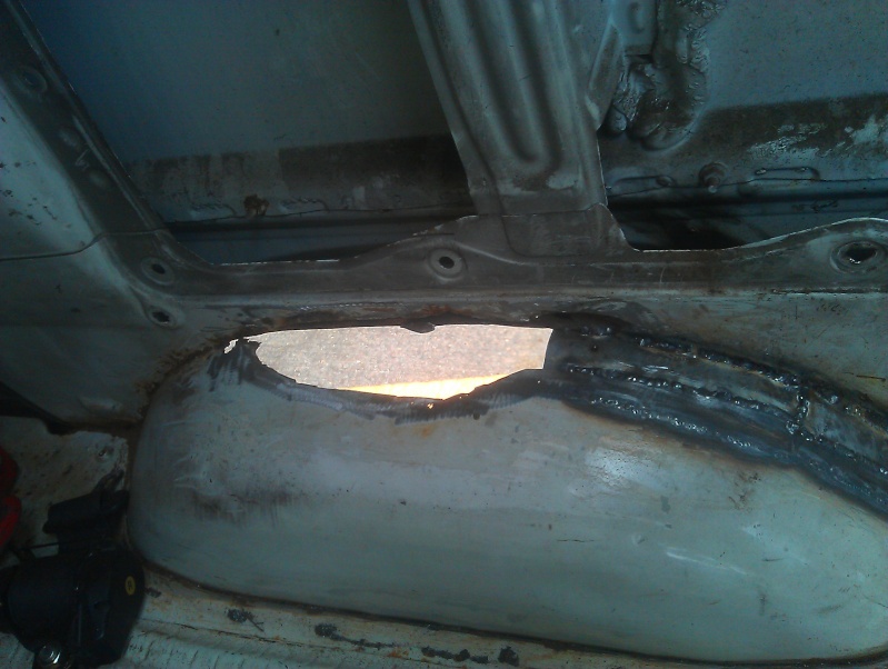

ok finally sortedmost of pics out so here is the rest of the arch repair
as you can see all rust cut away, fuly seam welded inside and out then anti corrosion primer and then a good lashing of underseal.
