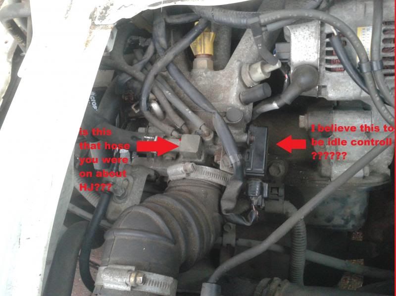

Post by simmo116 on Wed Oct 02, 2013 5:09 pm
ok couldn't find what you were talking about.
here is the noise my van is making when up to temp.
all hoses are hot and heaters blow hot as they should when I adjust the idle control it stops but is reving higher than it should.
checked what vac lines I could see and they all seem fine.
am at a loss now as to what to do.

Post by HighlyJetted on Wed Oct 02, 2013 5:52 pm
"I believe this to be idle control" - Afraid not, that's the throttle position sensor.
Not sure what that other pipe is, but doubt its coolant return/feed as the pipe is too big.
My stab in the dark would be this one:-
That is because it is about the right thickness, and it has a metal hose clip to stop it popping off.
The return might be underneath the throttle assembly.

Post by simmo116 on Wed Oct 02, 2013 6:14 pm
ok. when I unclip the throttle position sensor it stops hunting but revs are higher than normal idle speed. ill try that one when I get back from the big smoke on Monday. all I need is a pair of dolls hands to get in there now lol .
so is the idle control set by ecu?

Post by HighlyJetted on Wed Oct 02, 2013 6:37 pm
When you unplug the throttle position sensor,
The ecu no longer tries to make it idle, as it no longer knows the throttle is closed. Thus the hunting stops.
The idle is partly controlled by the ECU, what it has is a "target idle speed" say 900 rpm, and if its above that it retards the ignition timing and fuelling to try to pull the idle back down.
There is a screw under the rubber cover that is set at the factory which controls the air gap that maintains the idle speed. This will be set perfectly.
I would 100% say its either the water isn't going round the idle control valve OR you have a minor vacuum leak. I would totally remove the possibility of the idle control valve bleeding before I spent too long hunting for the vacuum leak. Because bleeding the idle control valve takes minute.

Post by simmo116 on Wed Oct 02, 2013 6:43 pm
and that's the (green) hose you highlighted?
