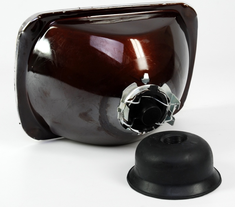

Post by HighlyJetted on Tue Oct 15, 2013 5:14 pm
Very good research and investigation.
I think those lights for sale on ebay take the standard H4 lamps,
The black thing is a gap filler for the new headlight, so during transport, stray items don't get inside the lamp. There are the 3 lug gaps for the H4 bulb.
So although they are sold for Rascal fitment, they do not use a standard rascal bulb.
Re: rascal running gear
Post by rich the mechanic on Tue Oct 15, 2013 8:11 pm
The black bit is the rubber boot to cover the back of the bulbthe connector going on after the boot is on.
Post by HighlyJetted on Tue Oct 15, 2013 8:18 pm
Not that bit, the bit in the back of the headlight!!!
Post by rich the mechanic on Tue Oct 15, 2013 8:34 pm
HighlyJetted wrote:Not that bit, the bit in the back of the headlight!!!
Hadn't spotted the bulb blank wrong angle on the screen. confused
Post by Gra on Tue Oct 15, 2013 10:09 pm
These light units are not idelly suited for the Rascal as they do not have a provision for the sidelight. They may suit some of the early Suzuki variants though. Some later Rascals did have light units with H4 bulbs.
