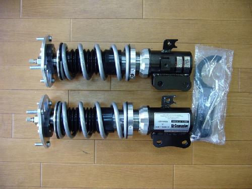

I'm looking into those bits for my 1.3 myself and not coming up with much. My supplier lists track control arms and lower suspension arms but the latter is ludicrously expensive and the pictures are unclear. I really need to start stripping to get a better idea but not had time lately. My supplier lists this:
but that may give you some part numbers I haven't looked yet and I desperately want these that 8bitash found:
if only.....

Ooooohhhhhh.... how much for them shockers and where did he find them?
At least the ends are available somewhere.

I'm not going mad on the porting & polishing, no heavy material removal, just port matching, a good polishing and casting imperfection removal.
As for the shockers it looks like eBay Italia so far unless anyone has any info?
