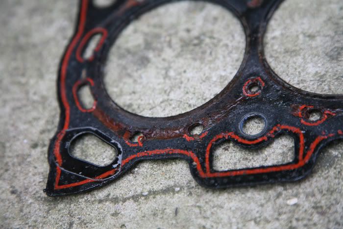

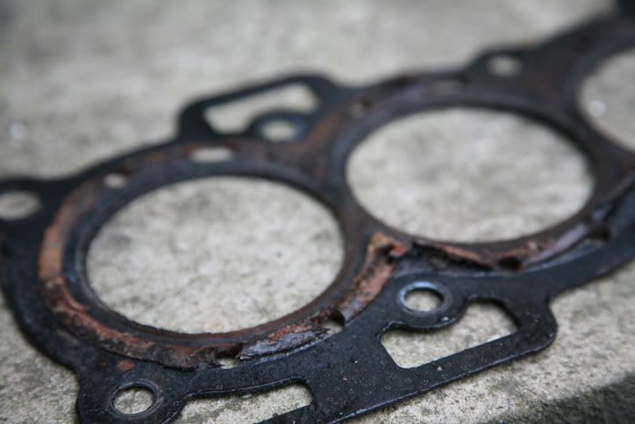

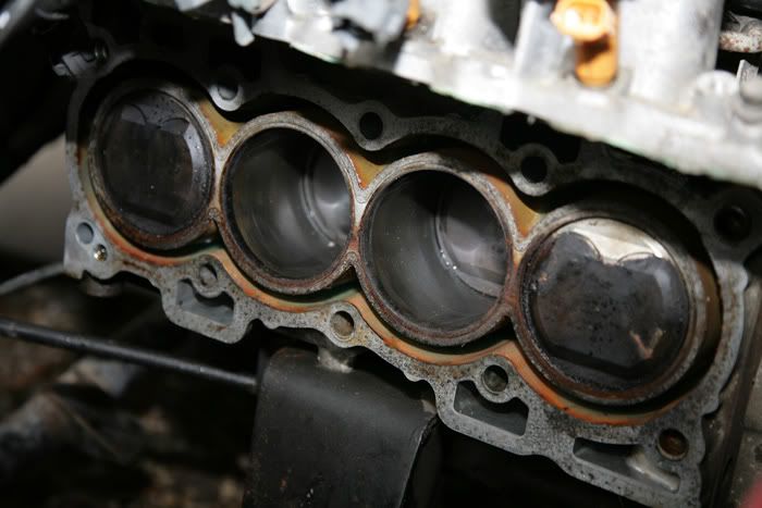

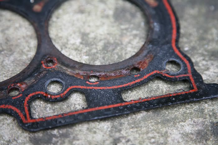

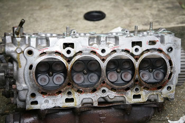

Finally got around to taking the head off today- This is the first HG i've done, took about 3 hours to get the head off so not too bad, Theres alot in the way especially with LPG too. Anyone with more experience in the field of HG's got any idea whats going on from the pics -
Re: Heatgasket 1.3 efi
Post by rich the mechanic on Tue Oct 12, 2010 9:33 pm
I would say that all four cylinders are blowing across to the water jacket (the lower side as in your first pic) and I would check that the head is flat use a straight edge along, across and diagonal across all 4 combustion chambers you will need to turn the cam round so the valves don't get in the way if it is flat check the rad doesn't have a leak on the back as found ours does after I changed the HG again and on refill wondered why the floor was really wet!!!!!!!!!!
