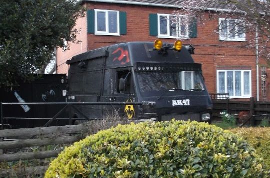

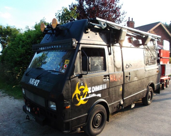

Just come across this topic and this sentence got me wondering
Eightpot wrote:...  The plan is to convert it into a dayvan/stealth camper....
Do you mean as in something along the lines of this?
