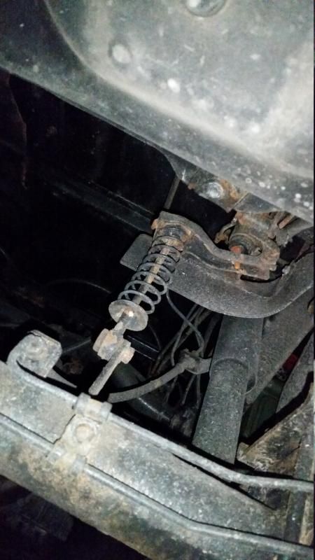

Post by Timosaki on Thu Oct 16, 2014 9:19 pm
I'm planning on flipping my rear axle this weekend, but can anyone tell me what this spring and its appendages are?
Thanks!

Post by PFM on Thu Oct 16, 2014 9:30 pm
Boing! Time for bed, said Zebedee. Brake load compensator, methinks.

Post by Timosaki on Thu Oct 16, 2014 9:32 pm
Ah, so it is sort of important to get in back in the correct position.

Re: spring thingy on the rear axle
Post by HighlyJetted on Sat Oct 18, 2014 9:58 am
Changing the LSPV for a T piece is an MOT failure Sad
If it wasn't, I would do it every time!
I do find it a bit worrying that someone who is going to seriously hack up their hijets rear suspension, doesn't understand a common brake system component.
But we all have to learn somewhere.
Post by Timosaki on Sat Oct 18, 2014 11:50 am
Measured and measured, and decided not to go for axle flip. I am changing the spring package instead. Flipping the top spring, and removing the middle one. I will have less load capacity, but all i ever haul is bike stuff. Pictures will come later

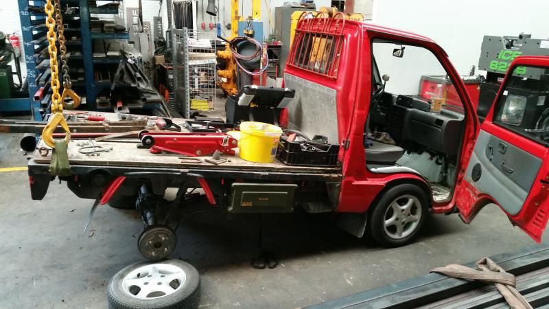

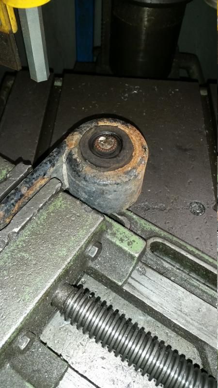

The workshop for today:
[/URL]
The original and reworked springs
[/URL]
Hooray for a couple of seized bolts. Took about 3 hours for the complete job.

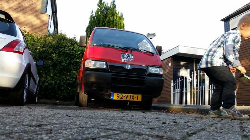

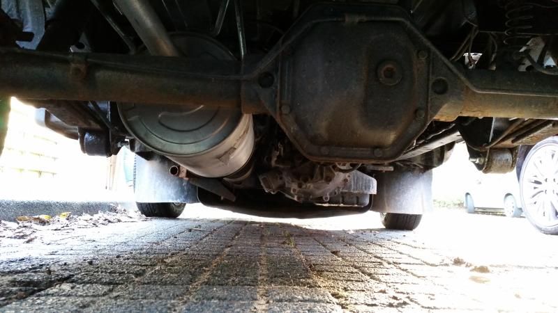

And the new stance. I kind of like it.
[/URL]
[/URL]
But the front bumper has come up a few cm since the back was lowered. I'm thinking about adding a lip of some sort
[/URL]
The front is now 8,5cm lower and the back about 9,5cm lower.
I made a new mount for the lspv, 9,5cm lower than the original. Not made a photo of this yet.
