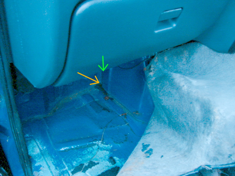

Post by harrythehamster on Mon Nov 09, 2015 8:25 pm
Checked this out at the start of a downpour and found the ingress coming from a join to the right hand side of the passenger footwell as per pic, green arrow is the join, it comes out of the bottom, forms a little pool where the orange arrow is, then when full flows down toward the bottom right of the footwell where it pools up and soaks into the carpet:
Tracing how the water is getting there from the other side is going to be a bit trickier though. Might try sealing it up at the weekend.

Post by Raggy on Mon Nov 09, 2015 8:29 pm
Hmmm, will have a look in the morning, not checked it since. Was starting to think it was down to a badly fitting winding window seal, rain going down inside of door but thinking back, door was definately very dry when I went in to sort window etc, so you could be onto something. I'll post back if I find similar.

Post by PFM on Tue Nov 10, 2015 7:05 pm
That must be almost below the heater matrix.....
