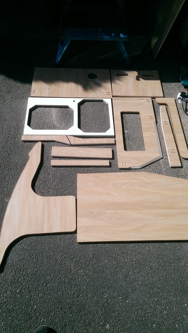

This is how it starts, one 8x4 sheet of lightweight Vohringer ply
Not bad to cut, just been using a jigsaw and a good eye to follow a pencil line Smile
All cut, trimmed with T edging where required and drilled. Now which bit goes where?
Drilled it as per original using pocket holes, makes it much neater and stronger joints apparently.
Nearly there, just drawer fronts to sort then install hob, sink and connect it up.
Posts : 1052

Cant take credit for the design of the kitchen unit as I just followed the pattern of the old one. Adding a new slide out shelf though and changed wood from 18mm MDF to the 15mm lightweight plywood. Seats will follow similar to existing setup just altered a bit to suit what I need but outwardly probably wont look design wise much different.
