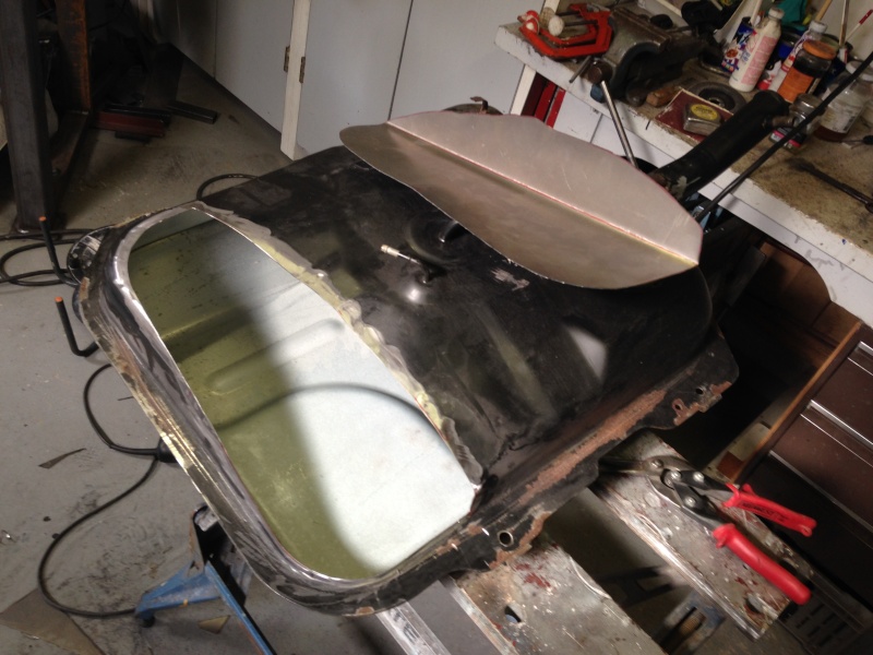

From the 27th March I've took 2 weeks of holiday to work on the Pick-up. Because I want to drive it before the good weather comes Smile
I've continued with the back of the car, and tried to make a ramp underneath the floor of the car. I didn't wanted a short one because the floor of the pickup is much higher than my van. If the ramp was to short I could get a problem with the angle of the ramp. So when you push up a moped or motorcycle the engine will touch the floor when the front wheel is on the pickup and the rear wheel is still on the ramp. (hope you guys follow me ;p )
But fitting a ramp underneath was harder then it seemed. After trying 2 ramps, the third one could be the one to fit.
We made a guiding rail and now the ramp sticks out a bit over the engine. So we checked the clearance on my Van by driving it with the engine cover removed. One driving and the other one in the back to see how much the engine moves. It looked possible, but then the fuel tank was the second challenge. It was a bit rusty anyway so cleaned it, and tried to hammer is smaller:
I noticed that it wasn't an option, so i took my angle-grinder out:
After welding it, I've performed a leaktest to check the weld, after closing a view tiny holes I gave it some paint and it came out like this.
As if the fuel tank wasn't small already Razz

OK, let's see.. I showed you the ramp and all necessary modifications to fit it, and the exhaust. But the title of this topic is 'Woodbed' so let's continue!
I've fitted the metal strip's to hold down the wood and drilled a lot of holes that day.. and made sure that everything would fit nicely later on.
It also took half a day of grinding to make the hinges for the side and tailgate. (5mm of steal strip takes a while)
This is what they look like welded:
In the mean while my father fabricated some cabinets to fit underneath the floor. One for each side. The left one also needs to hold the battery.
