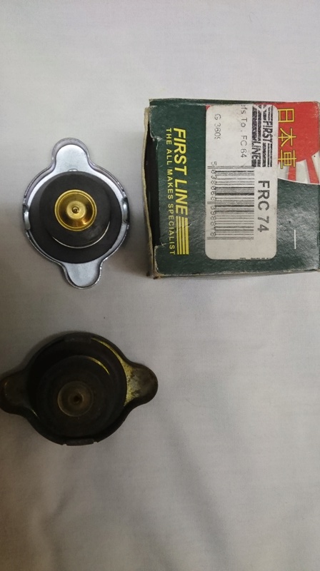

I have taken a few pictures of Rad-caps for you to compare which I will put up shortly from another tablet. After I have eaten.

Post by Woodie on Mon Jan 30, 2017 6:50 pm
First Line seem to be the easiest Radcap to obtain, but Nipparts or Blue Line seem to be of better quality.
The Yellow Chinese Radcap I haven't got a clue where I got the that from. I usually find all sorts of parts in glove boxes, boxes of bits and pieces new and used in a Hi-Jet that I have bought for re-sale or for dismantle for spares.

Post by Woodie on Mon Jan 30, 2017 9:28 pm
Odd thing is it looks brand new. I have also found 3 of the 993cc plain radiator caps with the chains still on them. Second hand though.

you could giveit a flush out but first instance looking at those pics are definitely some new rad caps. Yes they are the same, also make sure the seat in the pipe it seals to is in good condition not rusted up etc else changing caps won't do anything. May have some pics in my Skylark restoration thread. The cap you have looks shot. That's the first thing before doing anything else. Possibly a relatively cheap and easy fix.

FRC74 caps are fairly easy to find and fit both places. Ignition should be off. Draining is easy - remove caps, unscrew the drain cock located on the hose going to the bottom of the rad - stick your head under the bumper ahead of the n/s front wheel and you should see it. Or, just undo the hose from the rad. Either way, you may (probably will) get coolant on you. It's a good idea to check the condition of the hose clips - original ones are sprung, not worm drive. Best practise is to replace them all with stainless steel ones, but let's stop you boiling up first.
