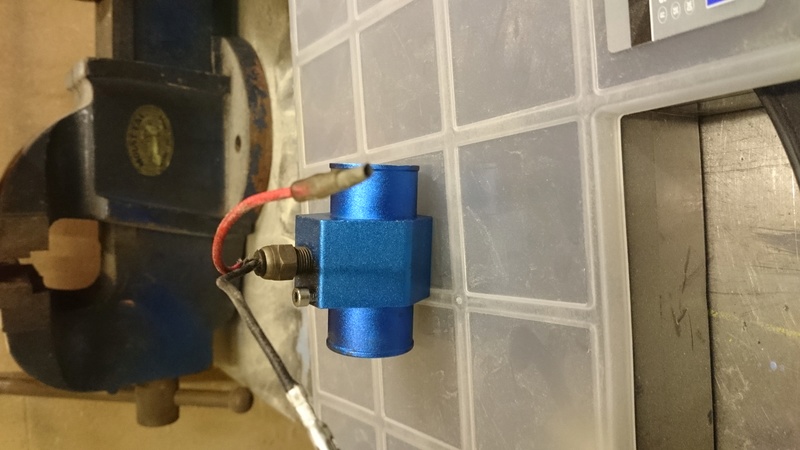

Post by Woodie on Fri Mar 10, 2017 8:45 pm
This one I got from a Hi-Jet I broke up a couple of years ago. It is a fixed temperature one though. Don't know what the temperature range is through. No markings on the Sensor.

Post by Raggy on Fri Mar 10, 2017 10:40 pm
You would have to sti k a meter on it and test with water to see if its a sensor or a fixed sensor that trips at a certain value. I would think its a sensor and would feed a control unit or variable switch so would work that way rather than being an integrated variable sensor all in one. Obviously someone had the same idea.

Post by Woodie on Sat Mar 11, 2017 8:58 am
It would definitely be an on/off switched sensor. The little brass sensors like this usually had just one spade or pin connector and used the vehicles engine to earth to send a current /signal, through to a live ignition switched instrument or a Relay.
This one because it is insulated in both rubber hoses would be an on off switch to a relay. It wouldn't be up to coping with the large amperage that a Cooling fan demands on start up.
When the fan cuts in on the 1300 it causes a huge draw on the battery and the alternator cutting in to meet the demands actually slows the engine down on tickover and if the lights are on as well it seems as though the engine is going to stall momentarily.
It is not so pronounced on the 993cc as the fan is a good bit smaller.
