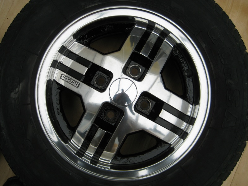

Post by HighlyJetted on Thu May 03, 2012 4:37 pm
1 Done (only 1st coat of black though) - 4 to go Smile
Before I do any more I am going to invest in some good abrasive flap wheels and mops - and get the tyres taken off Laughing

Post by 8bit-ash on Thu May 03, 2012 4:50 pm
nice job on that one.
Re: Project Ernie
Post by Logi on Thu May 03, 2012 5:54 pm
Wow!!! Lookin good Smile

2/5 done.... I'll do another tomorrow as I'm quite enjoying it

Wheel number 4 is about 50% complete now too Sad Mad pale Rolling Eyes Laughing I'm getting really polished out now, but I saved the easiest one till last with the least corrosion Wink
