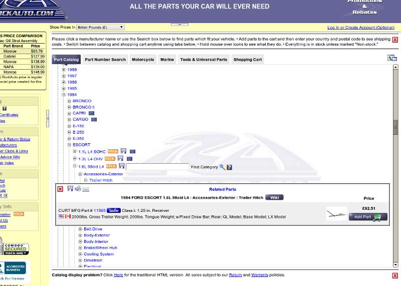

I'm not sure what the link is about that you've posted?
Some sort of towing brace for some old ford shite?

The link worked yesterday, showing a Hijet rad. Price in $ though, so not in UK. My local place (Brighton Radiators) did me an exchange unit for £92 in Nov 2009

How odd, i've tried it again and I get:-

At the top you can change to £ from $ and I had been looking at old ford shite the tow bar was looked at as it's heavy to see what the shipping was like but the link should have gone to this

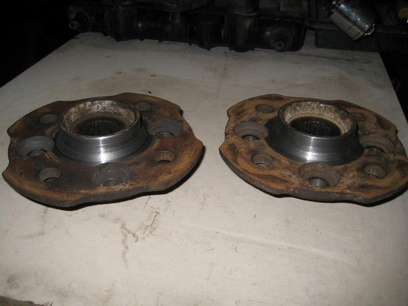

Tonight's playtime has been spent in my friends dads workshop, machining the hubs down to fit the bore of the mazda wheels...
