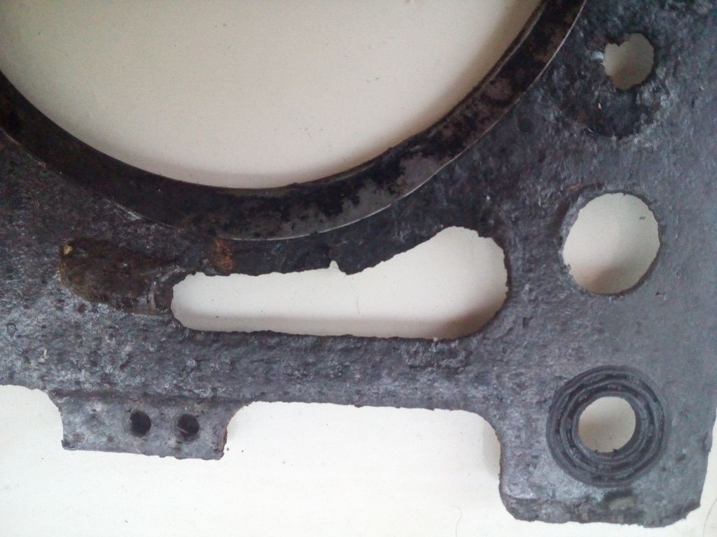

Hi all,
Well last few weeks I have been tinkering on the jet inbetween work etc. Finally got the head off today, my theres a lot of faffing with bits and pieces to get to the head let alone take it off. Also found out that what I thought was the tappit adjusters was actully the injector push rods Embarassed Mad So guess who is going to be trying to get the timing back on the jet?!
Anyway success and a cause has shown itself.
Doesn't look too bad untill you have close look at No4
Well that will explain the pressurization of the cooling system, same to the water guide on the otherside.
Looks like a few more miles and the ring would have let go!
Oh well now that I know the problem time to get the parts in and start the rebuild this weekend. Very Happy

Post by HighlyJetted on Wed Feb 29, 2012 4:10 pm
Bloody ace work Matty boy!
Now you can see why they don't get oil in the coolant when the head gasket goes. Most modern engines since the late 80's are like this, they tend to go between the water jacket and the cylinders where they fight the most pressure difference. Turbo engines are really bad for it as the cylinder pressures are much higher and the coolant system works even harder under boost conditions.
I'd be tempted to have a good look at the radiator pressure caps because if people have previous been taking them on and off alot they loose their seal and the spring goes knackard if they have been fighting with over pressure. If the coolant isn't kept in the system upto their proper rated pressure then the coolant will boil off and you'll have the same old problems all over again.

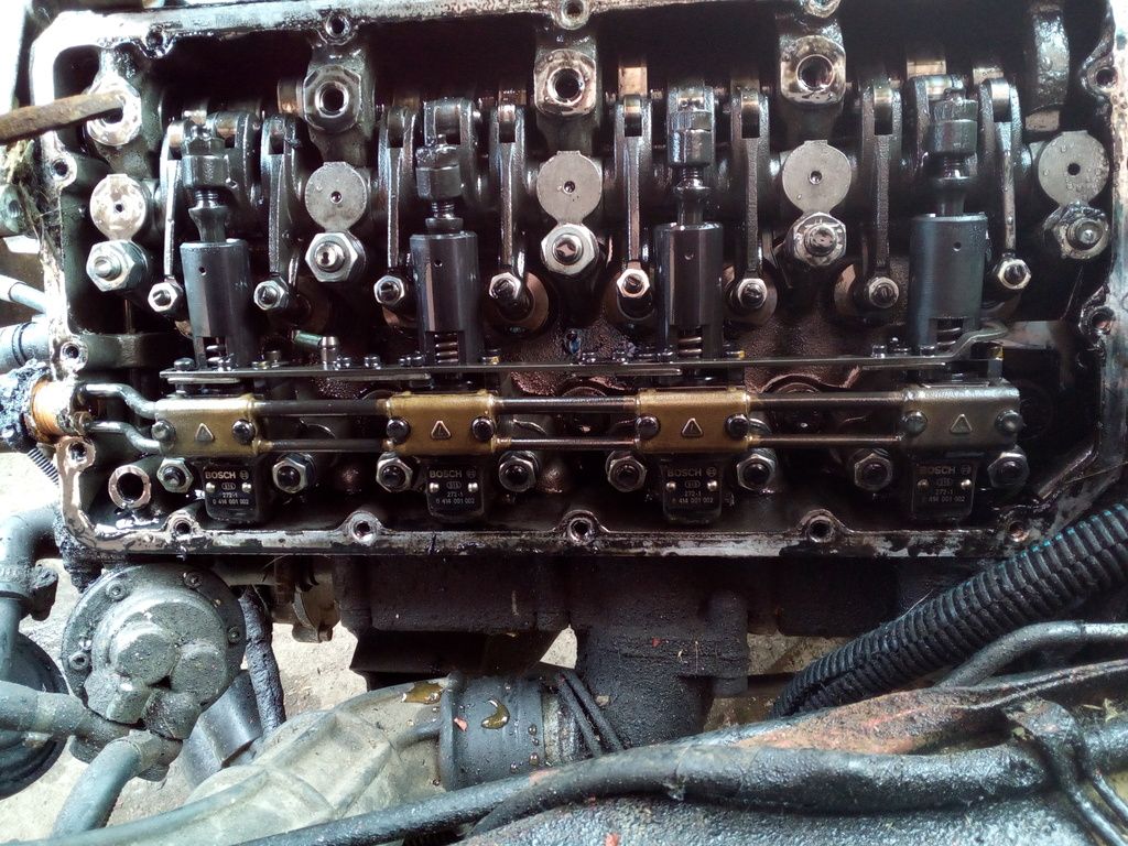

Post by Matt Angell on Mon Mar 05, 2012 8:17 am
Well got the head back on and all the other bits back into place, but spent the last day and a half adjusting the injector timing.
What ever you do, DO NOT undo the nuts that hold the injector pushrods in postion. Found a few hints and tips so far, if anyone else comes across this problem. First off if you have been stupid enough to have undone the nuts like myself, unscrew them all the way, then by hand screw them back in until they just touch the injector. Then put one full turn on and lock the nut. The van should run, but will be like a bag of nails. Then put quarter off a turn on each screw until the van runs sweet.
I'm still fine tuning mine, but there is normally about 2 full threads of screw showing above the nut.
Also to do this you have to have the rocker cover off, this WILL chuck huge amounts of oil everywhere! I have some pics I will upload later that looks like the engine has exploded!! You can beat this by putting the rocker cover back on, but to be honest I got fed up with putting those 11 screws in and out over and over. So a big drip tray underneath helps to limit the damage.
Also the batt goes flat quick with multiple starts, so make sure you have a batt charger ready!
So will update later, after another afternoon tweaking.

Matt Angell wrote:What ever you do, DO NOT undo the nuts that hold the injector pushrods in postion. Found a few hints and tips so far, if anyone else comes across this problem. First off if you  have been stupid enough to have undone the nuts like myself, unscrew them all the way, then by hand screw them back in until they just touch the injector.
Have you managed to achieve a balanced diesel delivery quantity on all 4 cylinders?
How did you do it?

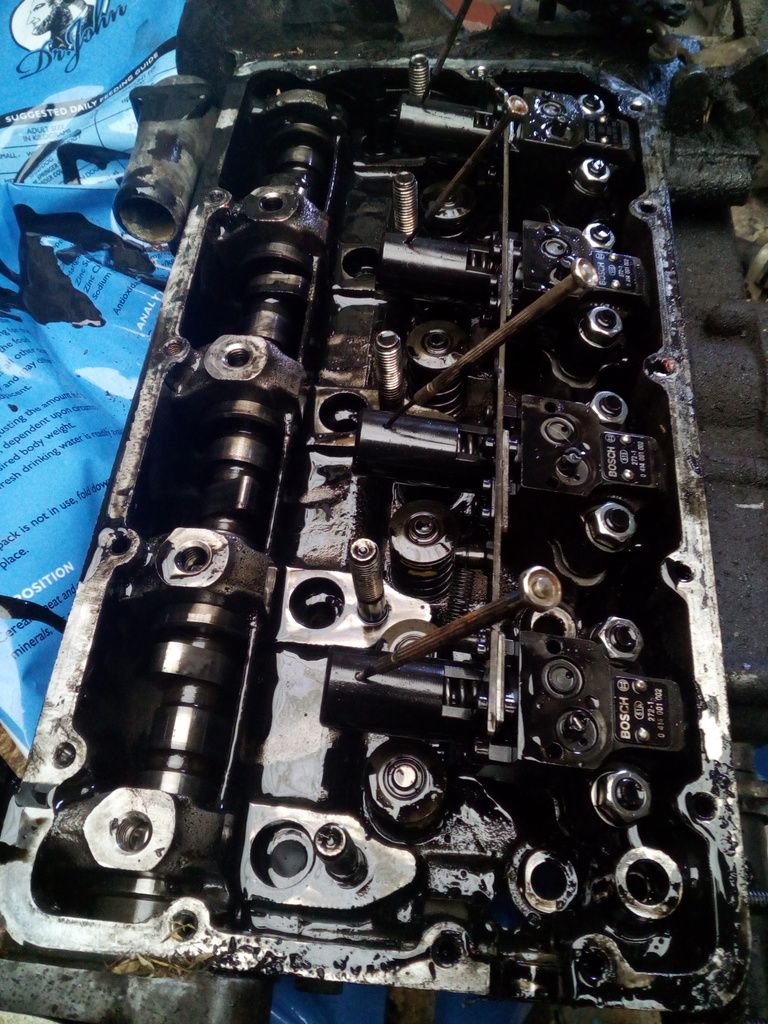

Post by dennispenis on Thu Jun 30, 2016 7:16 pm
twop twip...the crank pulley has a left hand thread lol
any ways rocker cover off reveling some really weird shit man
next lock the injector pumps up with a nail and take em off
