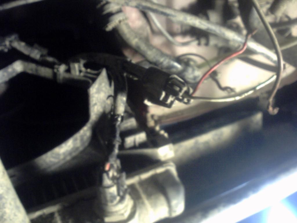

Post by Little Black Van on Wed Nov 07, 2012 4:41 pm
Right, been attempting to trace the wiring of the radiator fan, and I can see the bodge the previous owner did, but no trace of the original wiring. I can't see where the fan switch is either, it's not visible from where you claim it is HJ, just to check, are you thinking of the 1.3 or the 1.0? I have the latter.

Post by HighlyJetted on Wed Nov 07, 2012 5:23 pm
I'm thinking 1.3 sorry.
Rich will be able to help you i'm sure
Re: Questions...
Post by PFM on Wed Nov 07, 2012 5:29 pm
On my 993's the fan switch screws into the bottom of the rad, at the rear, I think on the opposite side from the drain screw. Any bodge to the wiring is likely to be evident in that area, I'd have thought.

Post by Little Black Van on Wed Nov 07, 2012 6:15 pm
That would make sense, since the bodge is right next to the rad. I'll have another look tomorrow, though it did look like the wires coming from there led somewhere, but they may just be tucked out of the way. While I was searching, I looked around the thermostat housing and found what I thought may be the switch, but is probably a sensor due to only having one wire. Would this be the temp sensor for the temp guage?

Post by Little Black Van on Wed Nov 07, 2012 7:47 pm
Now, having looked at what I think is the rad fan switch, it has wires that go into a bigger cluster of wires, which then disappears up behind the dashboard, and the entire length of this cluster up until the interior is masterfully wrapped in insulation tape. Are these wires meant to go into this cluster, or have they just been taped out of the way? I'm unwilling to go hacking at the tape and risk cutting wires (it's in a bit of an awkward place) without knowing what those two wires are.

Post by rich the mechanic on Wed Nov 07, 2012 7:51 pm
Little Black Van wrote:That would make sense, since the bodge is right next to the rad. I'll have another look tomorrow, though it did look like the wires coming from there led somewhere, but they may just be tucked out of the way. While I was searching, I looked around the thermostat housing and found what I thought may be the switch, but is probably a sensor due to only having one wire. Would this be the temp sensor for the temp guage?
The temp sensor is one wire under the dizzy in the back of the head not far from the stat, the fan switch is in the back of the rad drivers side can't remember the size but it's about a 30mm AF brass hex with a black plastic bit sticking out and it is the same type of connector as the one that plugs into the fan.

Post by Little Black Van on Wed Nov 07, 2012 7:57 pm
Yep, got that, it has two wires coming from it that disappear into this cluster though. Should they do that, and if so, where do they come out? Because the wires from the fan are literally right next to the switch, but cut and twisted to two new wires which lead to the manual switch and an earth point on the chassis.

Post by rich the mechanic on Wed Nov 07, 2012 8:04 pm
I think a copy of the wiring diagram with the colours marked and a work out whats been added, on ours I spliced into the wires and added a relay so I could run smaller wires and a small switch back into the dash as I hadn't heard the fan come on ever and was too skint to get another at the time it has since been replaced as I got a spare in with the second hand rad I got, I think that the two wires for the rad switch are both brown but don't hold me to it.

Post by Little Black Van on Wed Nov 07, 2012 8:25 pm
Ok, so should I just take the wires from the rad fan and connect them to the wires from the switch, without bothering to find out where they go?

Post by rich the mechanic on Wed Nov 07, 2012 8:47 pm
with the ignition on and your fingers clear if you short out the wires the fan should come on and you can either run the van temp up and check the switch goes short with a multi meter or take it out and hang it in a pan of boiling water and do the same test. then if that works then yes hook it up.

Post by Little Black Van on Thu Nov 08, 2012 2:35 pm
Ok, shorted the wires from the fan and nothing happened, not surprising since no power supply was involved. Razz I still can't work out the wiring, the wires going to the rad fan switch have power going to them when the ignition is on, but they disappear up behind the dashboard, and I would like to avoid pulling off the dashboard again if possible.
As you can see, the wires from the switch go up into the cab, and they are connected and have power, but I have no idea where they go. I would assume that there should be somewhere the fan wires connect, since this is a bodge and not original. Any ideas?
