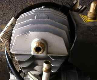

The compressor has two wheels and one foot . . . its inherently unstable and falls over all the the time. Last time the elbow joint broke.
Still have to figure out how to get the retained brass bit out, mole grips keep slipping off.

Post by HighlyJetted on Wed Jun 27, 2012 11:15 am
Blow lamp plus an easyout
http://www.ebay.co.uk/itm/5PCE-DAMAGED-BOLT-SCREW-STUD-EXTRACTOR-REMOVER-EASY-OUT-/190529701862#ht_2235wt_1199
they sell them in halfrauds too. Warning, don't snap the easy out in the hole, you cannot drill them out as they are really hard.
Otherwise I have this really nice set of snap-on grippers which bite even harder when you put anti clockwise force on the grips, who ever designed the jaws on them really worked on the shape and teeth.

Post by bwms on Wed Jun 27, 2012 12:27 pm
Thanks for that.
I wonder, do you screw one of these COUNTERCLOCKWISE into the hole of broken part, once it binds tight (look tapered), continued counterclockwise rotation is transferred to the broken part hopefully pulling it out?

[quote="bwms"]I wonder, do you screw one of these COUNTERCLOCKWISE into the hole of broken part, once it binds tight (look tapered), continued counterclockwise rotation is transferred to the broken part hopefully pulling it out?
Yes. Listed on the Toolstation website at only £2.52, so I'm off down there as I can't find mine and need to take a steering lock off my breaking van.

I got given a set but never knew how to use then. Do you drill into the broken screw the insert the extractor? or what.
Waz
Re: Rusty sills
Post by bwms on Fri Jun 29, 2012 7:24 pm
Drill a pilot hole into the broken screw/bolt. Then screw the extractor into this. I'll try and take a pic tomorrow.
