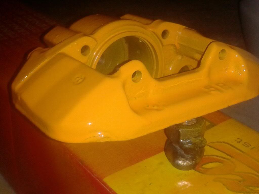

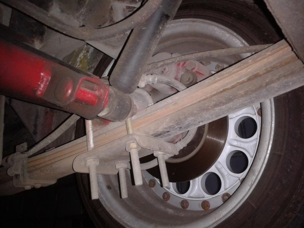

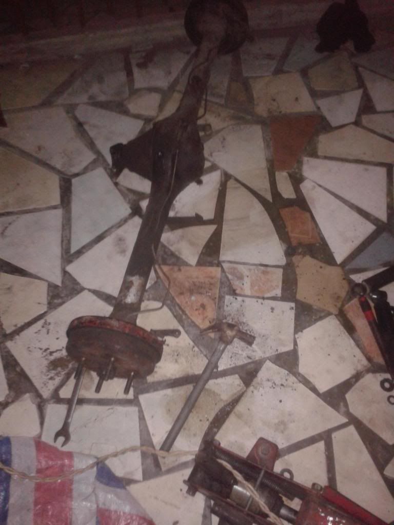

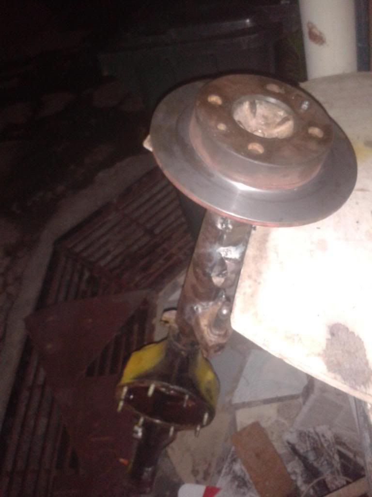

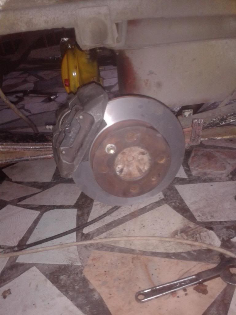

dint have much photo of my hijet update lately,this are all update since my last post~

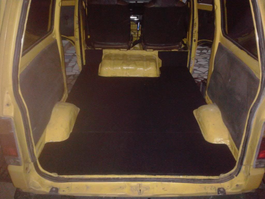

some done carpeting jobs

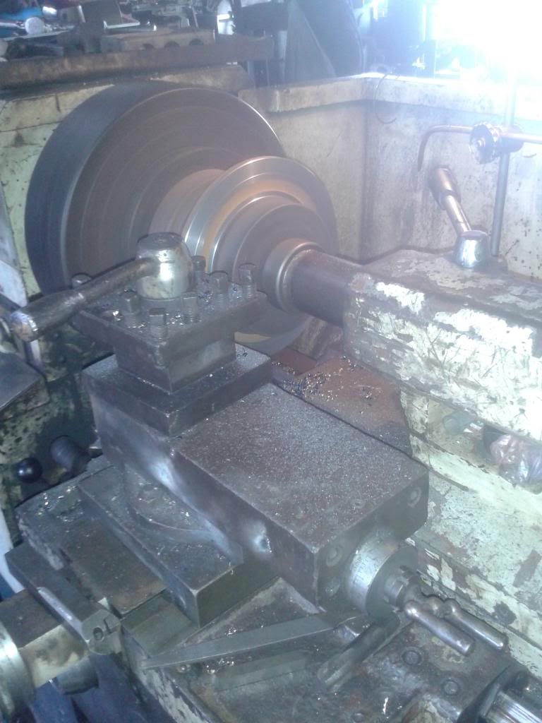

some fun time with my uncle lathe Very Happy

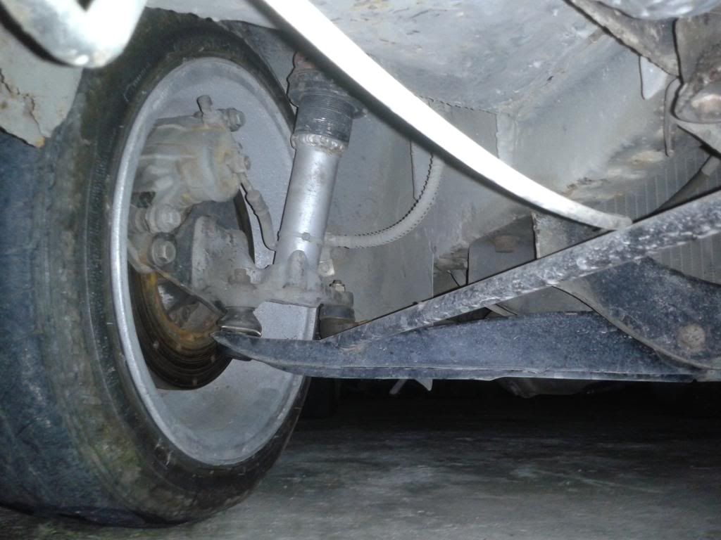

cut off old bracket and reweld in new axle~
read caliper positioning
hehe YELLOW Razz
and lastly,DONUT action!

How did you do the rear disk conversion?

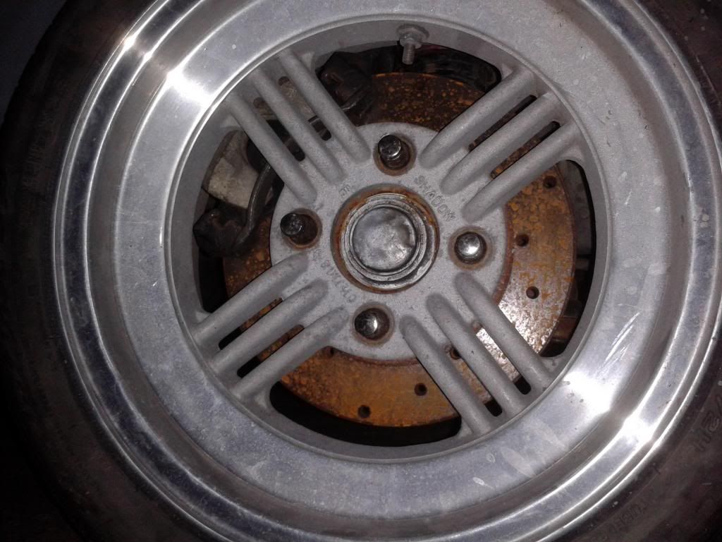

hmm,i changed the axle to a toyota ke10 rear end(wider around 2inch which helps me to put out the wheel abit without spacers)..reweld old axle brackets and fitted a front rotor disc and calipers from mira coure L7..im going to use hydraulic ebrakes..so no e-brakes cable is needed..about fitting the rotor disc,have to lathe out the center cap/hole..idk what it called,and a D.I.Y back plates that holds the calipers..its done now,but have no time to take pic..i'll upload tomorow while i fit a modified shaft for new axle ^^

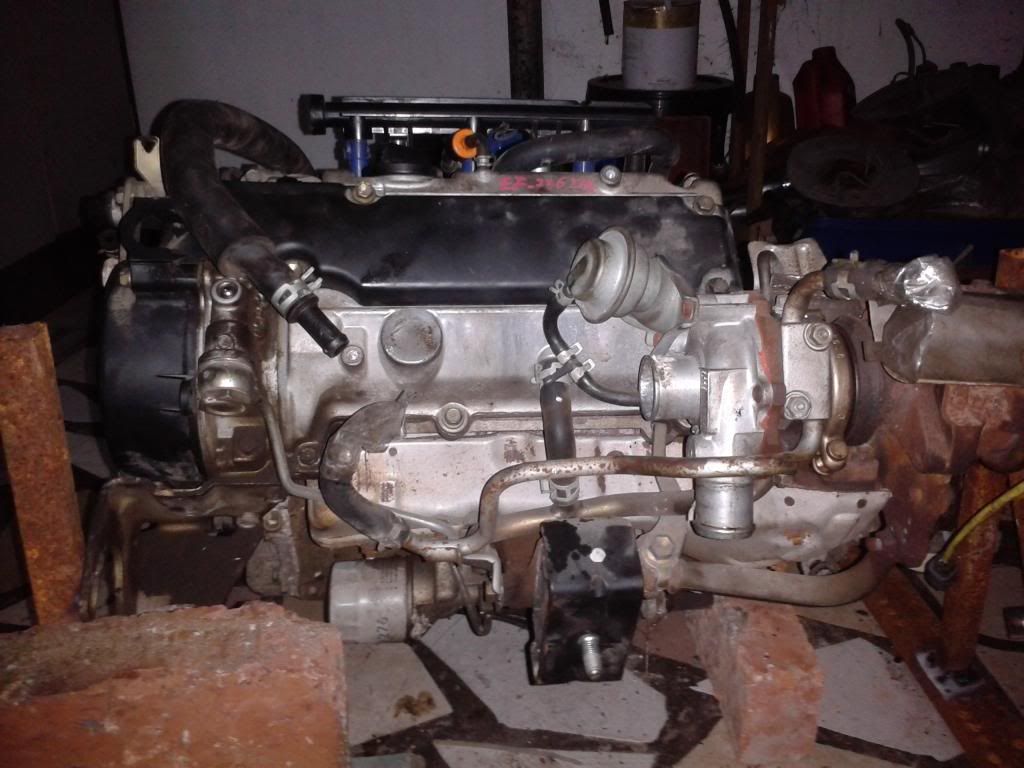

sample for johnnyboy666

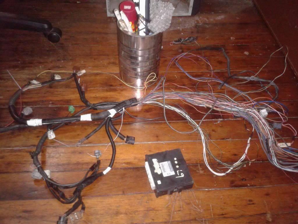

used 660 turbo engine going in soon,this is ef-det..will change the block to 1000cc and reuse old hijet box.

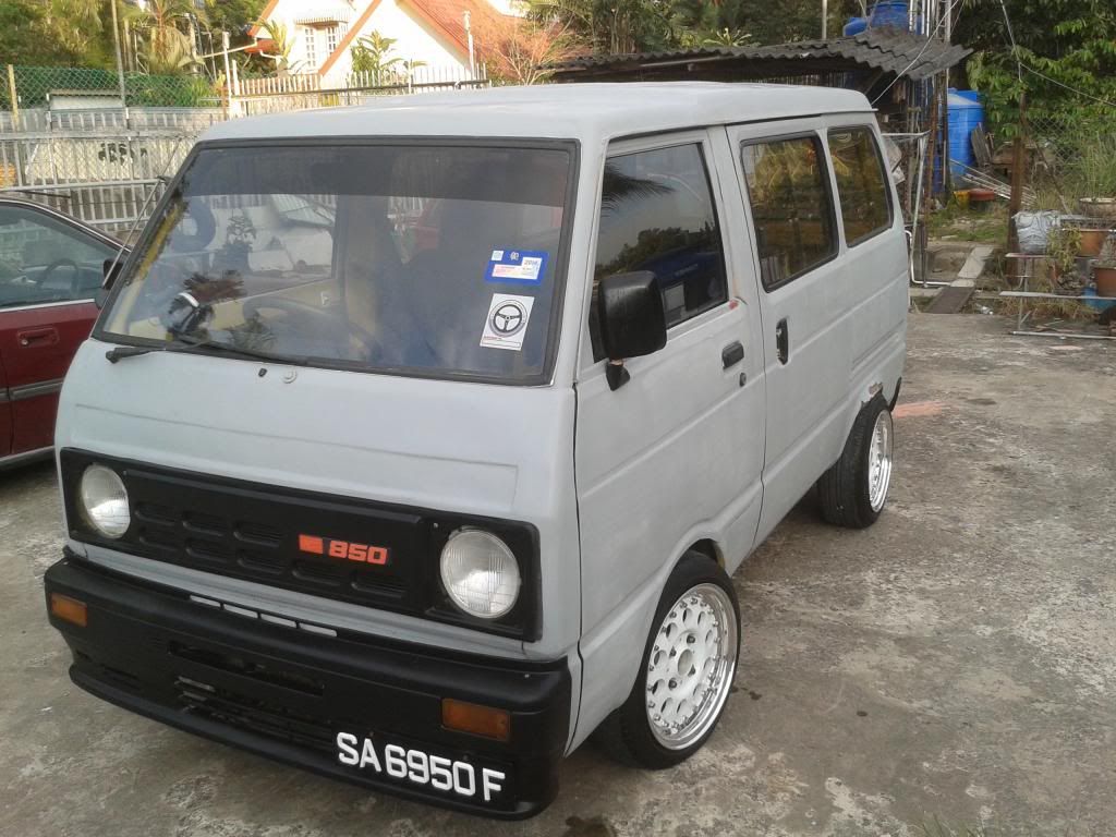

some pic update after sooo long Smile
sleeved front suspension+newer model hijet absorber(shorter),cross drilled rotor,just changed al bushing weeks ago..so for suspension wise,this minivan runs like a brand new one ^^..more to come soon,new paints,rebuilding and mods new engine in
having some problems with the turbocharged engine wiring harness,i need a wiring diagram for daihatsu l700/l900..could anyone help me with theses Razz

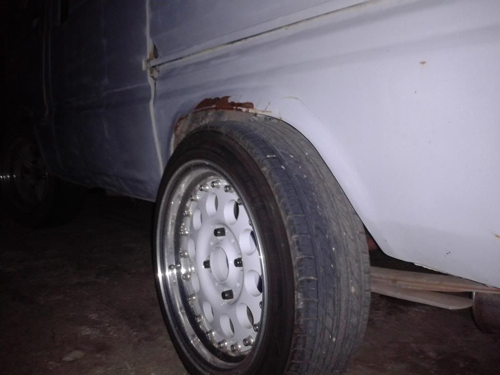

new wheels too Razz
