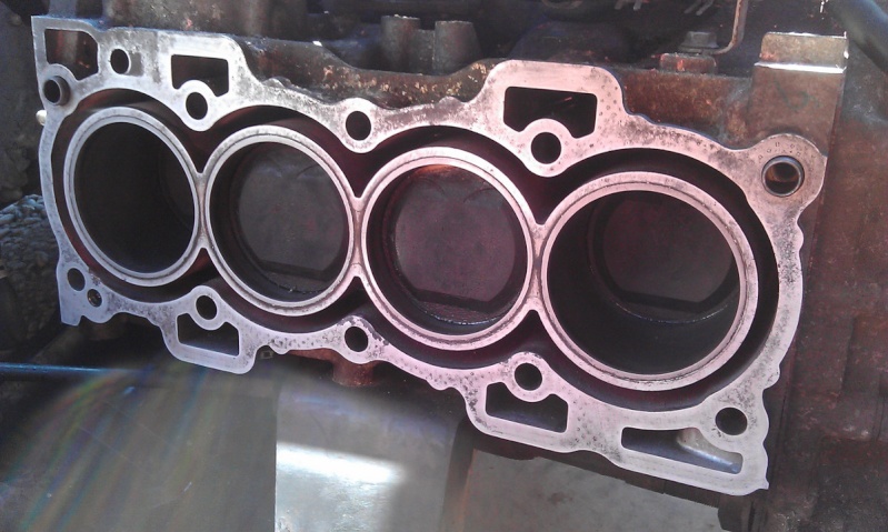

Just waiting on getting the head back now from the skim shop, here's my cleaned up block face:-
