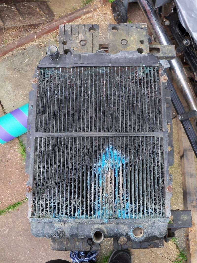

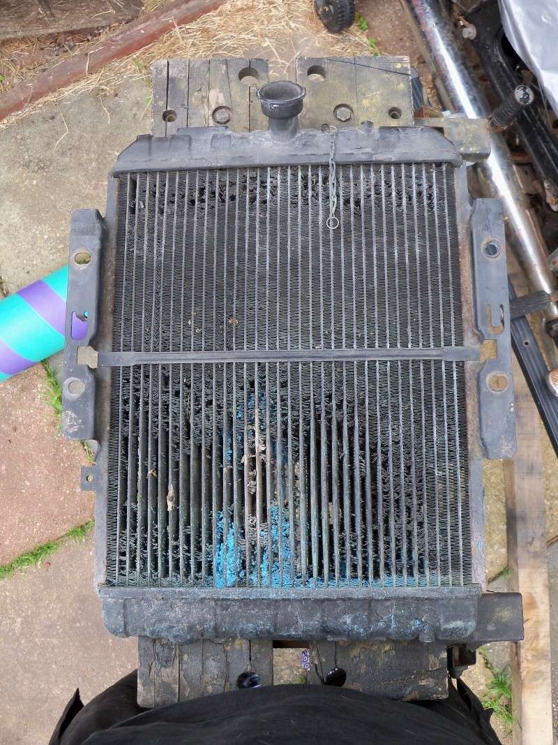

Post by rich the mechanic on Sun Sep 16, 2012 5:43 pm
Our original rad that has a hole and is well rotted
from the front as fitted.
from back as fitted no fan.
