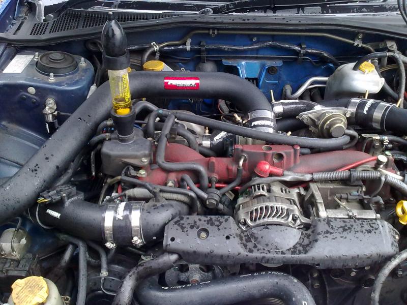

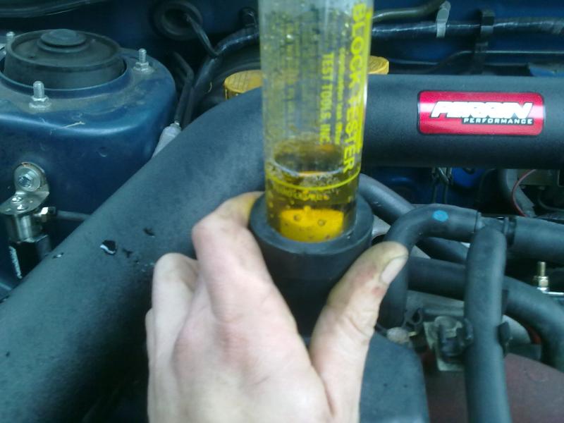

Tested my mates car with the block tester earlier, it definitely works:-
Now if you think fixing a hijet is expensive sorting this out will be bank breaker!
