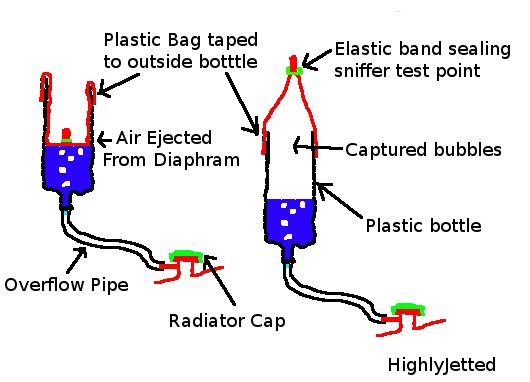

Post by HighlyJetted on Thu Sep 20, 2012 1:14 am
Here's my theory on doing an accurate chemical sniff test:-
First make a one off "header tank" out of some thing crude, sod the crap explanation, try this shit diagram Wink Arrow
Then take it for a good drive till your bag has ample newly create gas, Pull over and test it.
I'm just having stupid ideas right.

Post by elfin girl on Thu Sep 20, 2012 8:37 am
Hj, seems pretty elaborate, not sure I could drive around Using one hand cos I'm holding that thing tho!
I am however having doubts on the accuracy of the test, we did do a pressure test on the cooling system from the expansion pipe and although there was water coming out of the rad cap the pressure was slowly increasing, To 15psi, surely if water is escaping the pressure shouldbe dropping? And where else can the pressure be coming from if not the engine via the hg?
Doing more tests tonight
