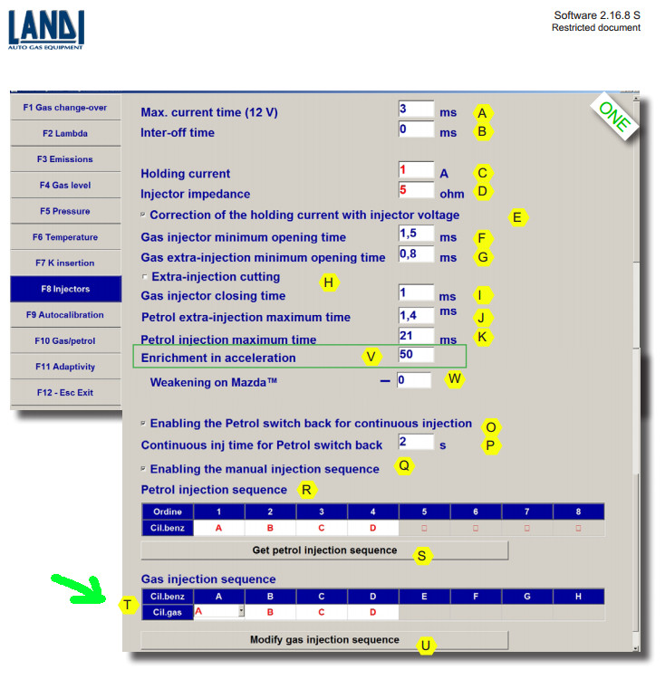

Then we tried to check the LPG map, and we find there are some wrong "correctors" (?i don't know their name in english, we have a chart on the PC that shows the parameters of the correction of the A/F ratio compared to gasoline map, in its fields there are a number, a percentage of modification of the A/F between LPG and gasoline, called "correttore" in italian).
Then we eliminated the "gasoline contribution" (contributo benzina in italian, at high loads the ECU sprays some gasoline with LPG to reach the A/F ratio and to cool the exhaust gases) and activated the auto adaptivity.
Then engine runs a lot better.

I think I understand exactly what you have done, your description is great.
It sounds like quite a comprehensive LPG management system you have on your hijet from the options you write about.
Hopefully the "auto adaptivity" or as I'd call it "closed loop" routines will tune your LPG map to run even better than ever, using your lambda sensor to guide the mapping of LPG.
The "gasoline contribution" method seems a bit pointless, it should be able to run 100% on LPG really.
I wish you the very best of luck with getting rid of this misfire. Our Prins LPG systems are very crude but work great.

The Landi (a common AEB control if I'm right) ECU for injected systems is so complex.
It allows to run the engine with the lowest fuel consumption, but is difficult to tune.
For some recent cars they send to the installer a pre bench-tuned ECU, but for the Hijet they haven't one...probabily because Hijets runs fine on the single-point systems, and they're used primarily for working purposes.
The "gasoline contribution" helps to save the exhaust valves from seat recession, but probabily our old injectors aren't too fast, and they sprays too much fuel, then I have the problem.
It's an useful possibility in my opinion, on our engines...
I must check the valve play soon to see if there are differencies between using it with the gasoline contribution or not...

Post by HighlyJetted on Wed May 22, 2013 10:07 pm
Being an odd guy I have just read into you system with an english manual I found here:- http://plimont.com/softwareLSIOne.pdf
Just an idea, but your low RPM misfiring could be cause maybe by these bits - "Tip in adjustment" or "Injector Sequence"
The ecu appears to auto scan for the injector sequence, but the manual says some stuff about advancing or retarding the sequence. At high rpms, the sequence timing has less effect, where at low engine speeds it can cause issues.
As for tip in, the reason most ECU's have both a TPS and map, is because MAP reading go unstable during tip in. Your LPG ecu has the "Tip in" modifiers to help this situation.
